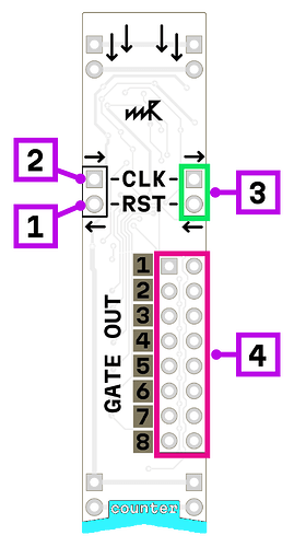

8-step gate counter module with adjustable step length and chaining capability

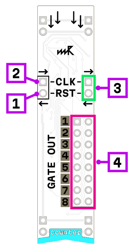

We have RESET and END pins together with CLOCK IN/OUT pins aligned on the sides of modules to be chained together indefinitely :slight_smile:

About enable, do you mean pin 13, clock inhibit? We can add 0-ohm jumper between ground to hack this feature.

Perhaps the proper word would be chaining: using two clock counter modules to build one bigger clock counter, so I could build a 16-step sequencer.
I’m still in the brainstorming phase, but I can’t think of a way to accomplish this without using the extra input (pin 13, yes).
A jumper would not be necessary. Just don’t hide the trace under the chip, please.
Good idea, I will think about it!
oh, I got it!
Check updated description, we will add independent/chainable switch to make daisy chaining available.
