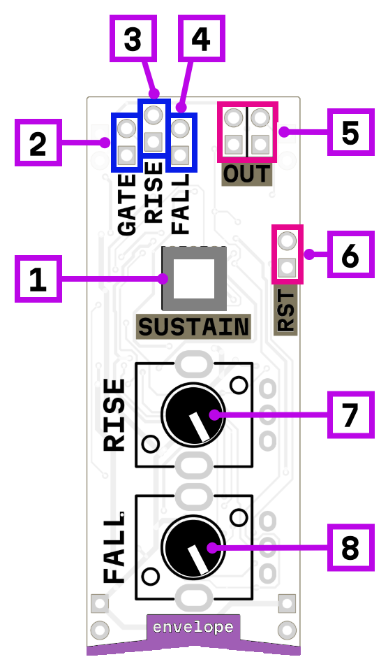

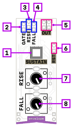

Envelope generator
Envelope generator with rise and fall control, sustain AR and no-sustain AD modes, rise and fall modulation.

Good news: envelope generator is ready!
Rise and fall time changes from 40 s to 10 ms, so you can use this module as envelope, as LFO, as slew limiter and as envelope follower.
