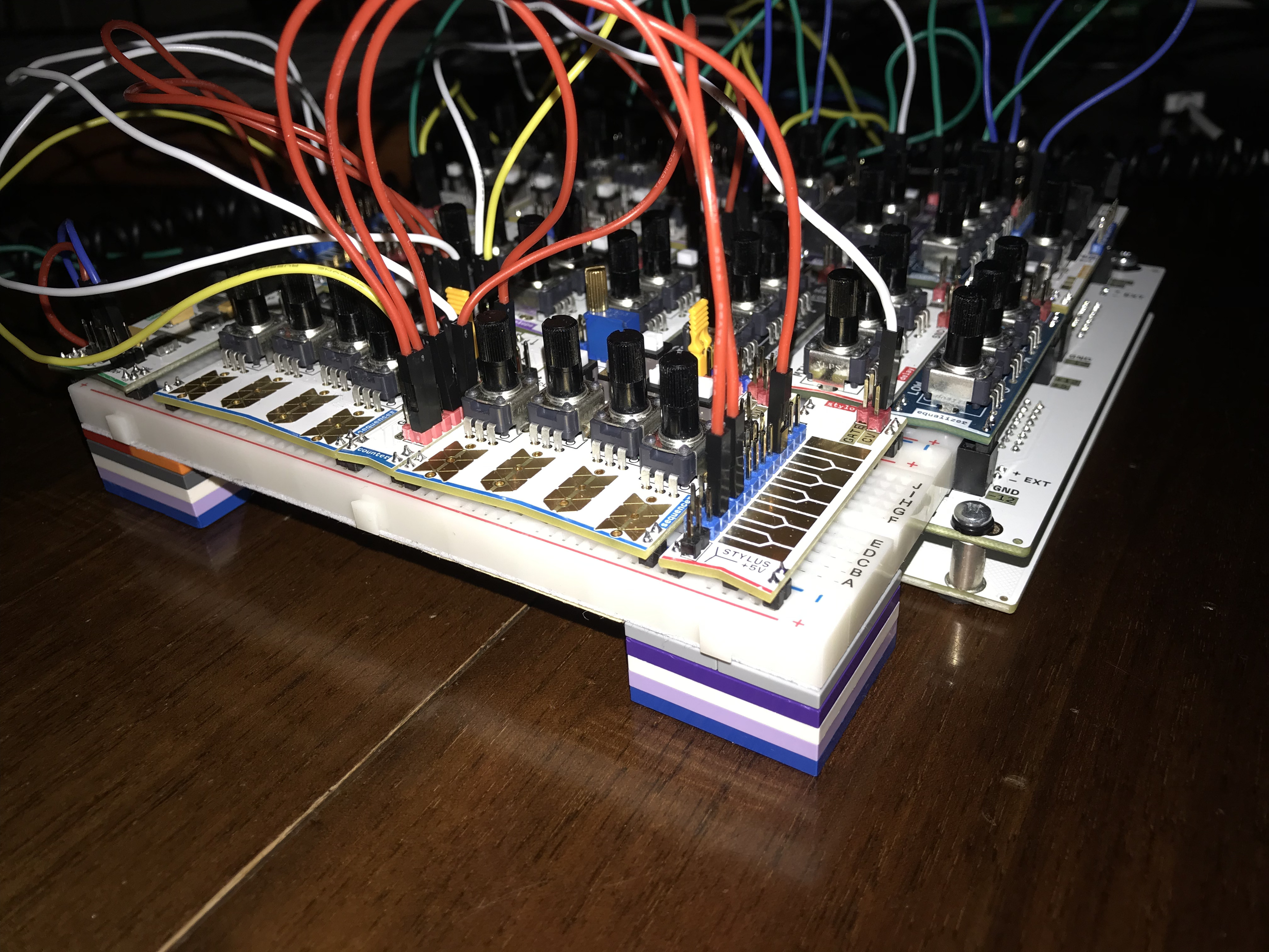

I also removed the middle screw on my chassis and snapped the third breadboard to another and added lego posts for stability, do whatever you’d like with this information)

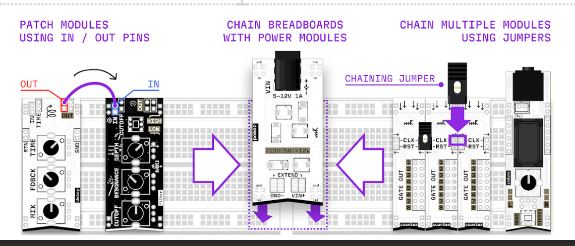

Can I connect two breadboards by using male-female jumper cables? Will it work if I connect the male ends to the breadboard power lines and female ends to the “extend” part of the power module? I would try, but it’s not obvious what should go where and I’m afraid to break something
Unfortunately, no. The “Extend” pins on the power module only pass through the input power (USB or DC) that you provide.
Microrack modules require +12 V, −12 V, and +5 V, which the power module generates from a single power source.
You can use a second power module and connect them together using these Extend pins.
Alternatively, you can place two breadboards in line and insert the power module (or any other module that fits) between the two breadboards.
