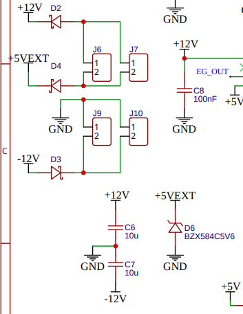

Recently I was motivated to read the electrical specifications again and found
A reverse-inserted module must not short-circuit the power rails under any circumstances!
Together with the recommendation of a 5.6V Z-diode between 5V and GND, which would
  • protect against voltage spikes :+1:
  • short-circuit 5V if the module was reversed :confounded_face:
An ordinary (or Schottky) diode in series with the Z-diode would prevent the short-circuit, but also increase the voltage at which the Z-diode would cut spikes.
You’re right, we must clarify recommendation.
Because in our schematics Z-diode is placed after protective diode
You can see D6 is on +5VEXT which is already contains reverse polarity protection diode D4 after bare pins.
And you are right: the protection against reverse polarity is already there, just not where I looked. I need to read the schematics more carefully.
