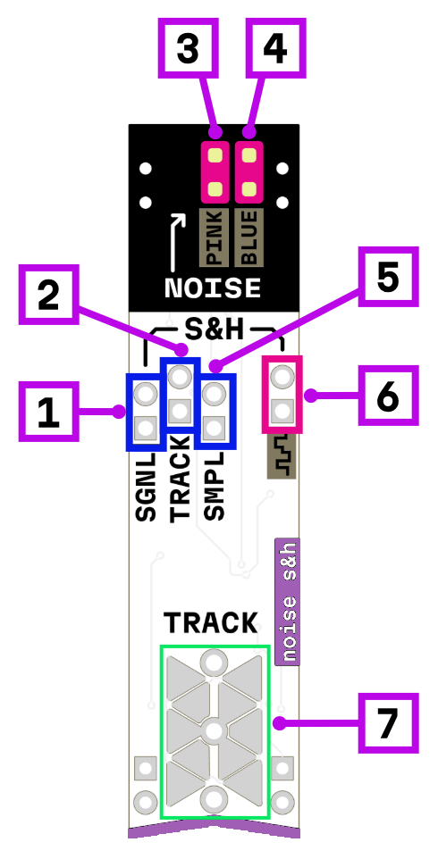

Noise + S/H
Blue and pink noise generator combined with sample & hold or track & hold and capacitive pad for manual tracking.

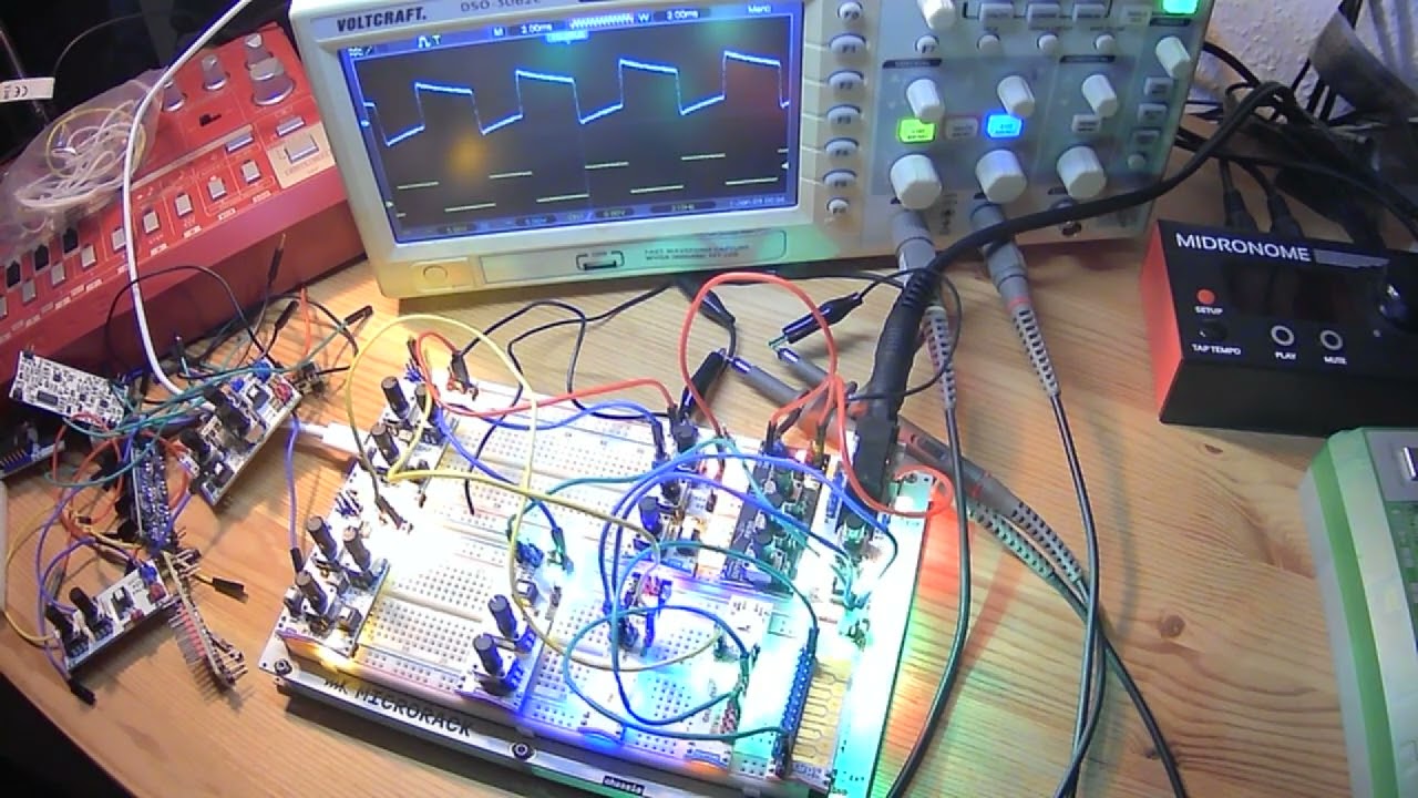

Hi everyone!
We have a cool update regarding the track/sample+hold section!
We’ve fixed the inverted logic, significantly increased hold stability, and corrected the sample input.
Now it really works like sample+hold!
