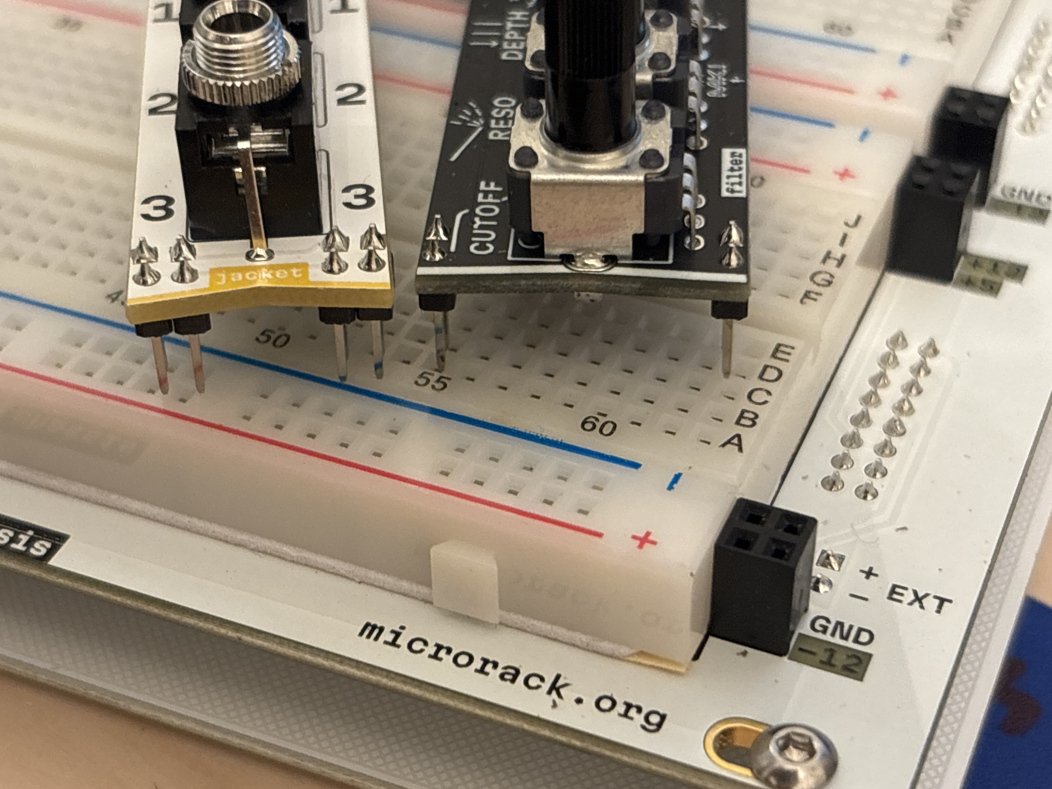

Power Bridging with single pin modules safe?
The manual says to do the power bridging on the chassis with (I/O modules then later mention power bridging with modules with pairs of pins)
So am I right to assume I shouldn’t try power bridging with something like the filter module which has single pins rather then the pairs on the jacket, input, output

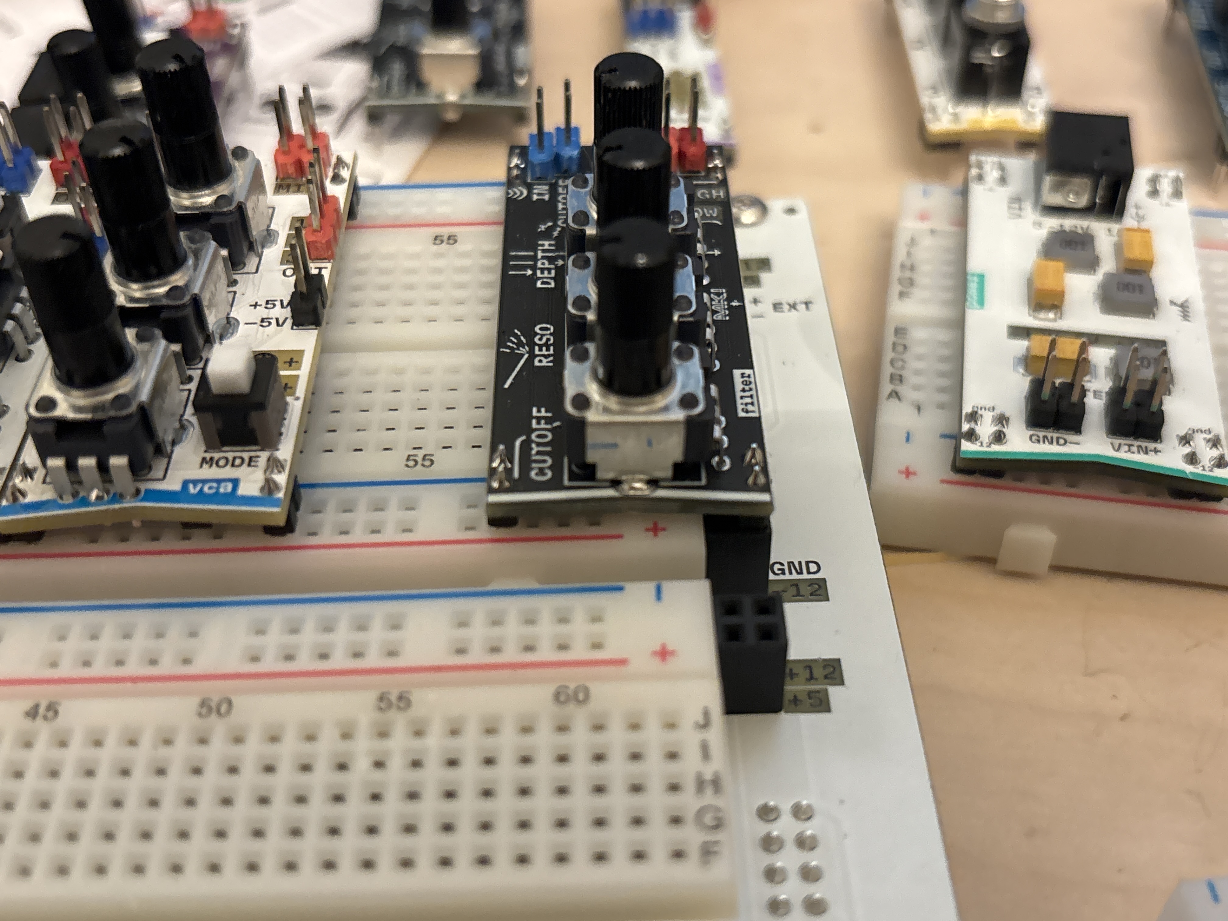

It’s completely legit — you can use any module (that fits, of course) to bridge the power.
The only issue is that single-pin modules don’t hold the breadboard as securely as double-pin ones, so be careful when moving the setup — the breadboards might slip out.
