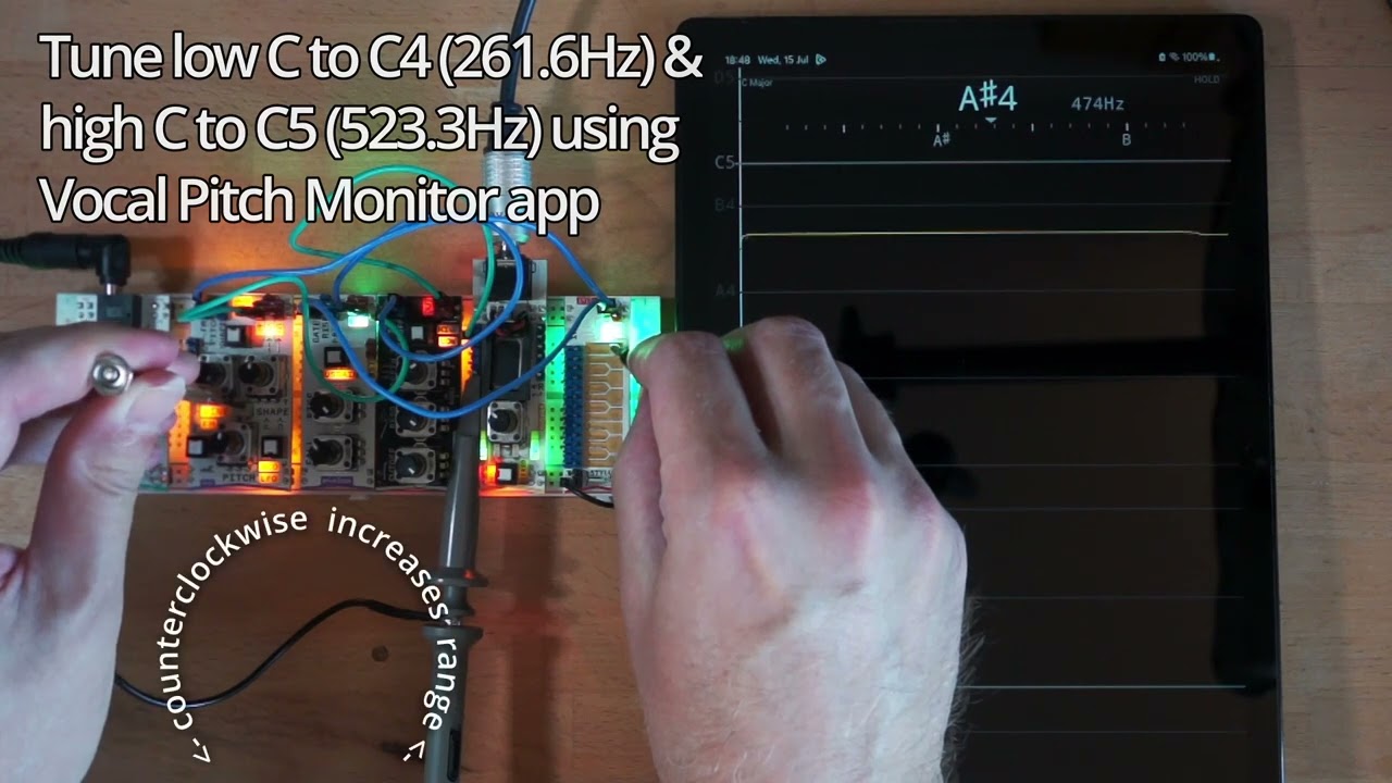

I have one more, might be my final one. I just penned an article on how to tune the oscillator including adjusting the trimmer pot: Instructables: Analogue Oscillator Tuning for Microrack Modular Synth
Most of it is covered by the video I made for that article.
